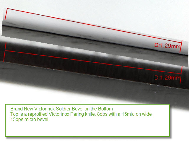

I've made so many knives in so many geometries, and generally i've like them all. generally id say they all have good cutting qualities, but they are not all good for the same thing.
This first image is one i posted to instagram to outline how i see so many knives promoted as being amazingly thin at 0.010" behind the edge at 15-20 dps. but this really doesn't feel that thin to me. as small as it seems, this form of apex edge can still be very prohibitive to good cutting in plastics, woods etc that dont seperate easily.
so this first chart was to show the difference in apex between one in a similar geometry to one of my small micro hikers, and a same knife had it been made from a normal factory at 0,010" with an overlay on the side to show the dramatic difference.

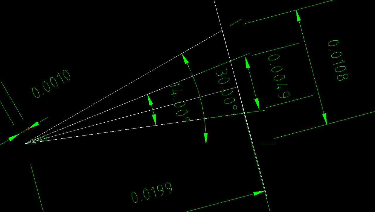

this image shows 3 different knife profiles and why i personally tend to go for somewhere in the middle of the 2 extremes.
the left section shows the 3 grinds up to the height where a 12dps scandi reaches stock thickness,
then to the right of the text is an apex closeup showing the overlaps up to the point where the FFG would hit its 0.010" BTE, and then far right is the entire edge cross section.
the reason i tend to go for the middle offering, or a convex version of it is to get the best of both worlds. i want the apex stability of the FFG at 15dps, but i only want it for enough to stabilize the apex against rolling.. so no more than 1-3 thousands in height. so this tiny bit may be subtly thicker than the scandi, but many scandi will also bolster the edge with a micro for the same reason. the scandi is liked because its thin apex can really bite in well, as can be seen from its thinness compared to the green FFG.. but the middle ground is even better to me, in that if you target 7dps (which is where a lot of real traditional finnnish knives not being cheap mora's are ground) then you really get the leanest bite into the material with good apex stability.
but the difference between the long 7dps bevel compared to how a FFG is ground is that you can go very thin on the apex, without the steel being too thin behind it. there is a good support structure that is even, the apex is not stronger than the backing which can occur with an obtuse grind on FFG.
that small increase in thickness behind the edge makes the knife a lot stiffer to support the thinner cutting edge. and in the terms of the entire knife, its really not a lot thicker than the FFG..
you end up with better entry, and stronger support.
the trick is fine tuning this and blending it to get the best attributes..

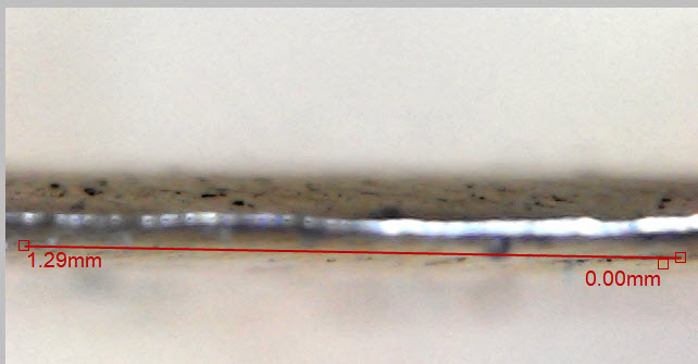

the above knife compared to a new swissa farmer blade for perspective
reprofiling again. this time im drawing vertical sharpie markers to get more precise estimations of the angles grinning smiley
calculations are estimated based on
thickness 1mm
spine to apex 14mm
raising spine 1mm
total height 3mm x 14mm is an included angle of 12, 6DPS
finish on dmt fine, now about 5.5dps...

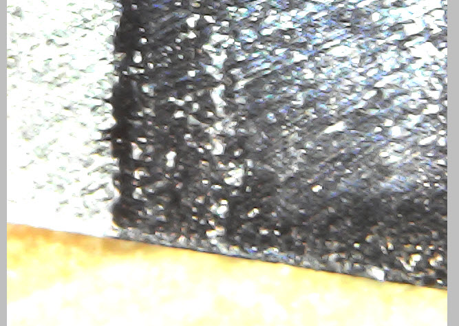

black sharpie, marked on the above bevel before raising and stabilizing
at 10dps as a microbevel, 2 violent cuts into bamboo skewer cutting clean at nearly 90degree left small deformation in the edge
this edge clean cut bamboo with this minor deformation
boosted it to 20dps and it was requiring a lot more force to cut bamboo.
and got more damage, possible from pre existing fatigue. 20dps to 0.003"

this is a nice representation of the apex up to 0.01" thick and the differences.. the tiny green bit 0.005" is the representation of the thick micro on the too thin support.. but in general.. you can see that there is a substantial difference in cross section if you get your edges under 10dps except for the very last portion
click image to get full view, but missing is the 0.004, 0,010" thicknesses of the 2 pieces
the 2 green micro bevels are showing the size of a 15dps, and how much is removed once you form 7dps, and have to back it up to 15.
so you will loose less steel if you sharpen to 15, then back bevel to 7, rather than 7 up to 15

these 2 videos are directly following the video above, no interruption.. and before the photo testing above. id done multiple regrinds..
so in this video the apex was subly thinner.. 12-13 and the backing sublty thicker 8-9dps
[video]http://www.youtube.com/watch?v=bl02vEP0ebM&feature=youtu.be[/video]
[video]http://www.youtube.com/watch?v=WtQjUsH8Ci0&feature=youtu.be[/video]
no real discernable damage..
bambo skewers.. good test.

what im trying to show with all this is that all these variances are in such a tiny area of the edge. its super important to experiment with the type of work you do and the materials.
for normal paring work, I'm not chopping kebab sticks. that original grind will cut a hard carrot-like its not there.
but look at the difference between 15dps, and 12dps, and more importantly the appropriate back support can effect big, small or no failure.
